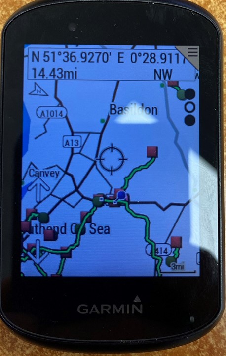

Anyone know if there is a way to turn off the green cycle lanes? they overlay the course track making it confusing.
That green line is not a cycle lane. I suspect it is actually your course. In the settings for the course see if the always show option is turned on. If it is turn it off and I bet that green line will disappear.
The cycle lane in that location does not follow the green line and it is the thin dark grey line to the left of the roundabouts.
The green line wouldn't be the active course. It would be other courses.
Note the red squares and green circles (ends and starts of other courses).
There's an option to "always display" a course.
Clearing out the courses should make all that go away.
Of course! they are strava segments! i have disabled all and now they are gone. thanks all. question is now can i still use strava segemnts without them screwing up the map?
If they are disabled they will not execute.
You will still gets results in Strava when teh ride is uploaded, but no real-time segment information during the ride.
