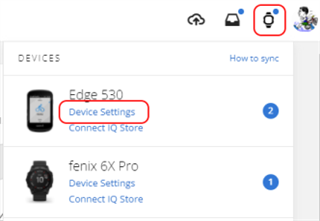

  • Have you tried to go into the https://connect.garmin.com/modern webbrowser. at the top righthand corner there is a watch icon which allows you to choose your device such as the 530, it takes you to the device settings, there is a tab for user setting and in there it has heart & power zones and how it calculates zones, there is a box for maximum heart rate. after saving the setting at the very bottom, I then usb plug in and sync using Garmin express, I also do this for every device.
