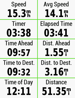

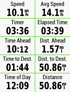

And then when I ride over my outward track for a short distance and eventually with 3 miles to go, the 530 gets confused as its telling me my distance to destination is now 50.86 miles, and then suddenly comes up with just 3.16 miles to go and it will take me 9 minutes 32 seconds
This is what I see all the time on my 530, is it normal for a 530 or is it not working correctly and needs replacing?
