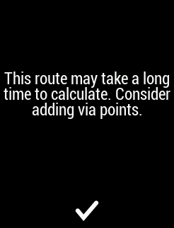

I was recently navigating a mountain bike route I had built in Trail Forks, but the route was not taking me where I had expected it to.  So I decided to bail on the route and tried to navigate back to start.  I selected "most direct route" and it popped up with a message "This route may take a long time to calculate.  Consider adding via points."  I thought that was strange, because I had ridden only a few miles at that point.

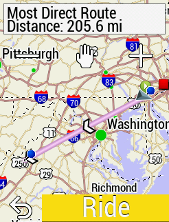

I tapped the checkmark anyway, and here's the point it took me back to:

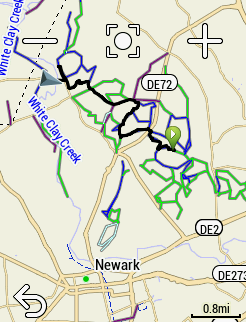

But here's where I actually was, trying to get back to my start point:
Why did the Edge try to get me back to a point over 200 miles away?  Interestingly, that is a point on another route I have saved on my Garmin.  So it is confusing routes somehow.
  • Somehow, the device got the wrong coordinates for the start.
    I would expect it would have used the point when you started the activity.
    The point it picked to navigate to isn't random (presumably).
