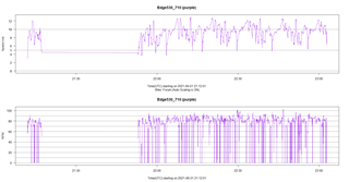

So it took me a while to figure out why my power numbers in Garmin Connect and Strava were completely different for the same ride.  What I think is happening is that the 530's default for power is to exclude 0's whereas Strava takes into account the 0's (freewheeling).  Can anyone confirm this?

  • You may not have stopped once you started the loop, but there was a long stop after you started the timer
  • Yes, that is accurate.  I got a call from work and had to talk for some time before I could get back to my ride again.
    I sincerely appreciate all the comments, but I think we may have gotten a little astray.  My original post conceded that some platforms were probably including zero's and some weren't and this is why there was a fairly large discrepancy.  The smaller discrepancies are probably due to how the power is being calculated, but it seems clear that including zeros versus not including zeros can provide a pretty big difference.

  • The default on all Edge units should be to include zero power values in the average and exclude them for cadence. I don't know how that got switched on your unit.
    The short answer is include zero power values. I cannot think of a good case for excluding them apart from trying to inflate your numbers.
  • Thanks.  Wow, that is super weird since I know I never touched that setting.  I bought this 530 through Amazon this past December.  It looked new, but maybe it wasn't.  You may have noticed from my FIT file that the elevation is all messed up too.  Garmin Support took a look at it and said something is wrong with the device and they have just sent me a replacement.  I'll be interested to see if include zeros is enabled by default.  As you said, I'm sure it is.  Thanks again.
