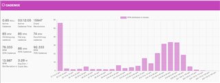

During my indoor ride I noticed that cadence displayed on 25 is almost stable +/- 1 when i cycle consistently with e.g. 90 or 100 RPM, but on 530 cadence in jumps ~85-93 often a few times a second.
Is there any setting I could use?

  • All gyroscope based cadence sensors are more sensitive than a magnet version because the magnet version is calculating your cadence from the elapsed time during 2 spins always on the same place, the gyroscopic is measuring it much frequent during 360degree (4HZ , 8HZ, maybe 64HZ and averaging it per sec,  maybe awatherall knows it better, and the exact "measuring place" is always different throught the 360degree). The Satori estimated cadence is much worse , that is trying to estimate it from the pulsating of your pedaling , sometimes it is close to reality, sometimes far off, so better to forget it :)
  • I understand this, but still its weird
    I dont get the point to use data between 0-5 rpm, its worth nothing; and provide an unaccurate average RPM
