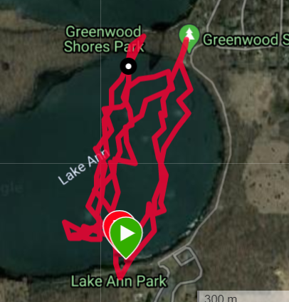

Oddly enough the Edge file has a really good looking track (I think it's complete and accurate) and the "speed" field in the FIT file doesn't seem to show any gaps.

FR935:
Edge 530:

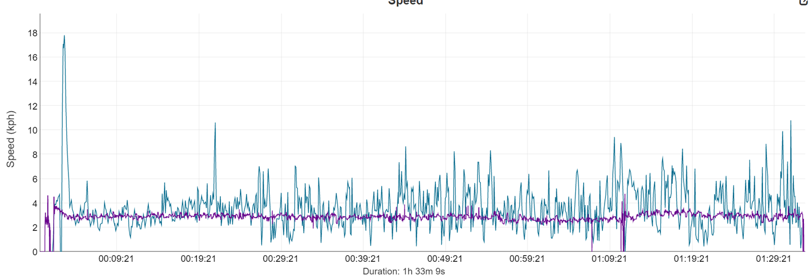

DCRainmaker Analyzer comparison of speed (purple - Edge 530):

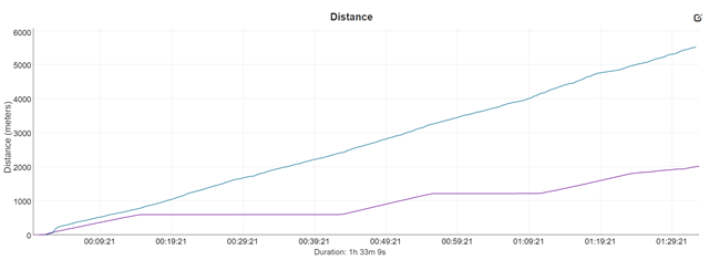

Here's the distance comparison... maybe Edge only adds to distance when the GPS signal is really good (yet somehow records speed)?
Interestingly if I strip out the "Distance" field using fitfiletools.com "Field Stripper" and then load to Strava, for example, it may recalculate correctly.
