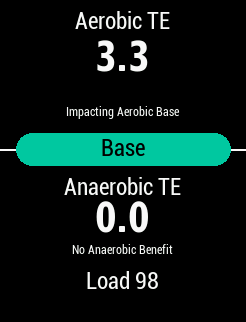

    I got the following sequence of screens at the end of my ride today:
