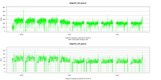

    Your workout has a number of reset periods that are long enough for the power meter to shutdown. When it shuts down it is no longer transmitting a power value of zero. The Edge is receiving no data in this period. No data is not the same as receiving a value of zero. Records that have no power data are excluded from the calculation as the Edge does not know what these values should be.Hence it looks like it is exclude zero values, but in fact it is excluding records with no values.
    Here is a section of the power data where you stop.The power meter sends zero power values until it shuts down. The NA values are the period of time in this sample where no power is received.

    This was a vEveresting event, so there are 10 brakes without pedaling which probably made the PM fall asleep after a while.
    FWIW, seems like GC power curve include NA-values as zeros.
    GC power curve 5h = DCR analyzer power curve 5h = 209W
