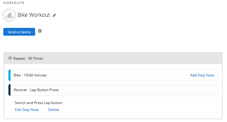

    So the alternative would be to create a simple workout that repeats, counts to x minutes then gives you a second step that ends when you press the Lap button only. This way everybody can get back in sync if necessary. Not sure if I can attach a picture of the planned workout, but I try. If you need to reset and resync at a random time, you can press the lap button twice to start a new countdown whenever, I think.
  • Thank you. I'll give this a try and see if we can work with it. It looks like a good soln. I'll let you know
