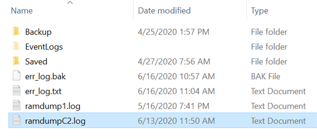

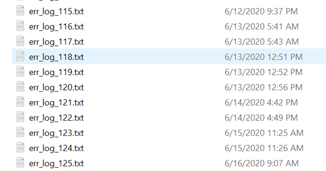

  • In looking for an Error Log to send I noted a ramdumpC2.log file that may align with my crash (47 MB or so), but I don't have an error log with the same file time stamp either in Debugging or Saved folder.  I have something like 4 error logs per ride, although I've only witnessed a single crash/reboot in all my use that I can recall.

    Other examples that show frequently:

    I'd be happy to zip my error logs and/or try to get the ram dump to someone if anyone wants a deeper look.  I'm on 5.51 beta as you see from the log snip above.
  • Build 5.51 has more logging enabled, including the ability for the unit to dump the RAM.
    If you could respond to the beta email  [email protected]. about the RAM dumps that would be the best place.

    FWIW, I sent my fit file and a link to my RAM dump to the beta email as well.
