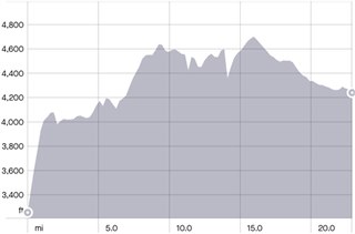

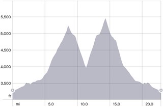

    After interacting with Garmin support several times and completing all of the various tasks that I have already described (including blowing in the barometric altimeter sensor holes and rinsing with water) it was determined that the barometric altimeter is faulty (as some of you predicted).  Garmin is replacing with a refurbished unit.  To hopefully help others that have a similar issue I am attaching two images that represent the correct and "as measured" elevation profile from the same ride.  The file with two clear peaks is the correct profile.  The other profile was determined by the faulty barometric altimeter.
    Strava corrected profile.  This accurately depicts the activity:
    Corrected
    As measured by faulty barometric altimeter.  Not even close to reality:
