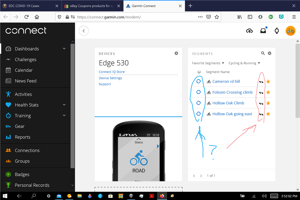

    5 days ago I went to the Garmin Connect Dashboard page and sent all 4 of my Garmin segments to my 530 using these buttons (red circle):
    Then I sync'd GC (webpage version, not app) to the 530. Next, on the 530, I enabled all segments. That was 5 days ago.
    Today I went for a ride, thinking that all 4 segments would fire. The 1st one did not. I stopped and again enabled all segments, and continued the ride. I did not re-ride the 1st segment (I should have, but I was getting tired!), but all remaining 3 segments did fire. I'm now wondering if every time I go for a ride I will need to re-enable all the segments? That seems crazy to me. I would expect that once I enable a segment on the 530 it should stay enabled for all future rides.
    Am I misunderstanding how this all should work?
    Can someone explain what these circle buttons do (highlighted in blue below)?:
    I'm not impressed how well the GC webpage talks to the 530. Lots of buttons to push, many not obvious. For example in this case of creating segments on GC and sending them to the 530. It should be a much simpler process: 1) create segment on map, then 2) send to 530 via sync. All segments sent to the 530 should automatically 'enabled' by default, and should always stay enabled until the user disables them on the 530. Just my 2 cents....I'm still learning.
    Overall I'm very impressed by the 530. The GC webpage, and the way the GC webpage communicates with the 530, not so much.
