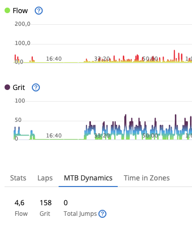

I have exactly same setup under MTB profile and also my jumps aren't registered. Why? Is this a 530 bug?
not even with the latest FW5.50 jumps don't register:
