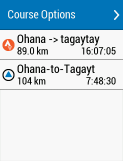

Did this activity chttps://connect.garmin.com/modern/activity/3844111612  and created the route beforehand. However, climbpro doesn't recognize any climbs. Am I missing anything ?
Note : Trying to upload the tcx file of the route I used but i got an error message when doing so.

  • just tried to reset unit and data but nothing happened. Two files one uploaded with strava the other one created on ridewithgps. Only Strava one shows climbs

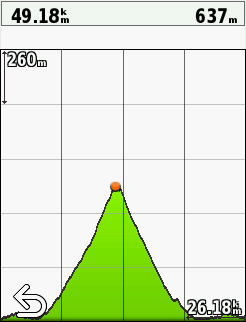

  • I think the 2 sites are using different sources for the elevation data. It appears that the elevation data from RWGPS does not pass the 3% minimum grade rule, while the data from Strava does.
    If you post the Strava file I can overlay the 2 profiles and we can see where they differ.
    I applied an offset of 365.8 meters to all elevation values so that you were starting at sea level.
    I took a section of the climb starting at 23.63 Km (elevation 93 meters) and ending at 49.18 Km and 637 meters.
    Elevation gain (Rise)= 637 - 93 =544 meters
    Run = 49.18 - 23.63 Km = 25.55 Km = 25550 meters
    Grade % = (Rise/Run) X 100 = (544/25550) X 100 = 2.1%.
    Climbpro is only as good as the elevation data it is given to work on.
