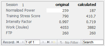

  • Garmin Connect does not compute any of the power stats. They are computed on the Edge and written into the FIT file as part of the session record. Stripping out the power spikes will not fix the power stats unless you also modify the session record.
    I recomputed the data and got the values shown below, which are contained in the new FIT file. If you wish to use them then delete your activity from GC and upload this file.
    3777095323-fixed.fit
  • Alan, you are a gem!!! Anyway I could do this by myself in the future or until the firmware is finalised. These spikes are bit of a pain Thumbsup
  • I used the http://fitfilerepairtool.info/ tool to do this. There is an option when you go to save the file to recompute the power stats.

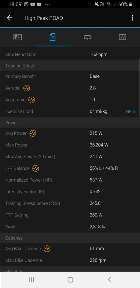

    You might want to try the 3.41 beta release. I ride with a V3 paired over ANT and I'm not seeing any spikes.
  • Oh, that's good to know, Alan! Were you getting spikes on the 3.20, too?
    I'm going to get the tool as well, just for insurance purposes. Thanks bud
