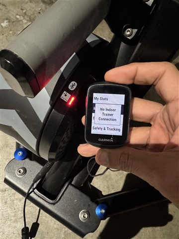

    •    Menu → Indoor Trainer = Always returns “No Indoor Trainer Connection”

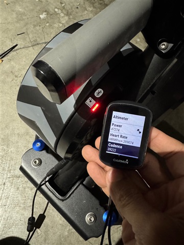

    •    Edge 130 Plus detects the KICKR as a power meter under list of sensors (presumably over ANT+ and BLE) but not as FE-C / Indoor Trainer.

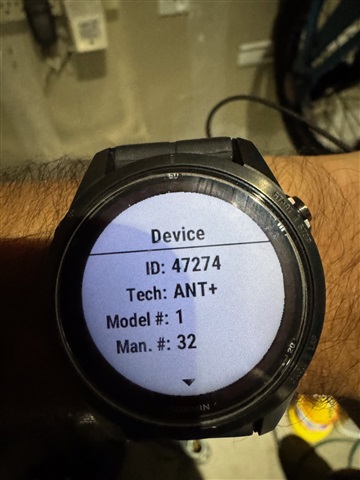

    •    The KICKR shows ANT+ ID 47274, which should be correct for FE-C.

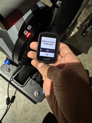

    •    Edge displays the trainer as “Wahoo KICKR B8AA” in the Power Meter list, but still does not show it in the Indoor Trainer list.

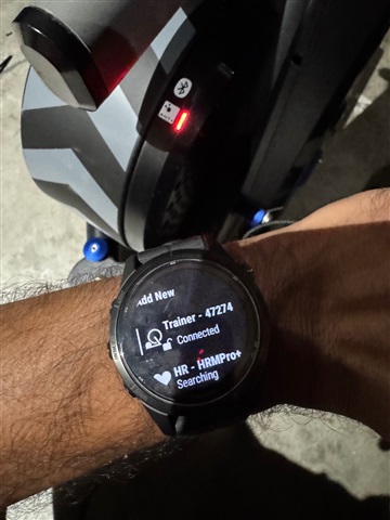

    •    Fēnix 7S picks up the FE-C trainer instantly and can control it without issues.
