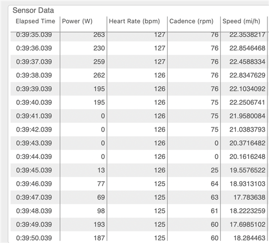

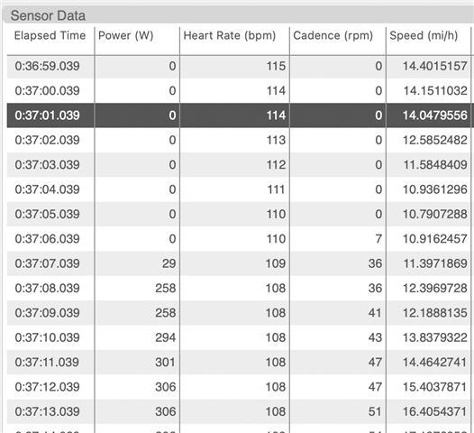

From a dead stop, the first 5-6 seconds of pedaling show no power data. 0W then you're going again.
Looking in the .fit file second by second, there's no data being written. Same for cadence.

Chart here is just an example. Columns are time/watts/heart rate/cadence/speed

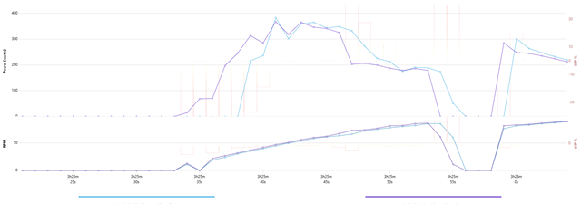

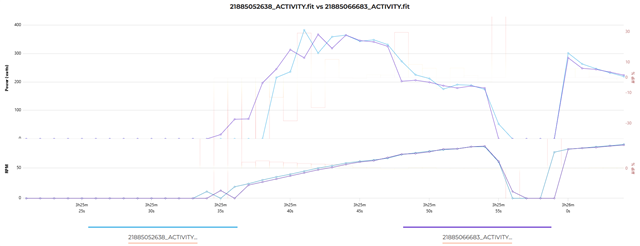

  • i searched a data from my yesterday ride (started with 50-11 from 0kmh), ok, it is a better Power2Max NG and not a Quarq, but spider-based and that is showing watts later also than the Assioma Pro RS2, look the graph: (purple Assioma PRO RS2, lightblue NG)
    below 30rpm the NG is not showing power just cad for 5-6secs apprx (1sec offset issue between power and cad), the Assioma is immediately. probably the Quarq is not showing both below a threshold cadence value

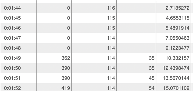

    with matching cad timestamps:
    with matching power timestamps :

    When coasting and no cadence, it behaves differently, see attached screenshot. At least when coasting the cadence is a zero. When stopped the cadence is not zero, it is blank.
    I think there is some kind of sleep initiated when there is zero speed and zero cadence, and it takes a few seconds to come out of the sleep.
