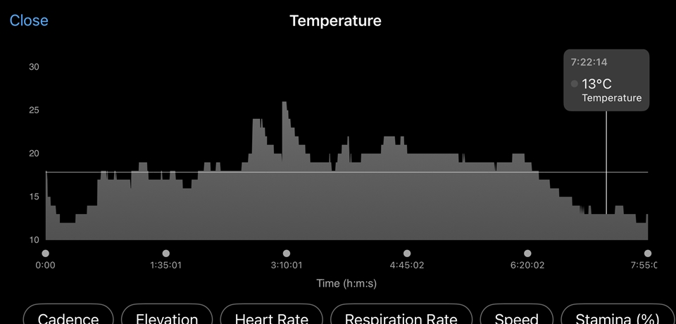

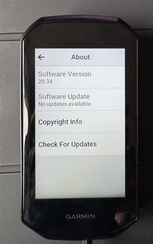

Since updating to 28.34, the touchscreen becomes unresponsive whenever the ambient temperature drops below about 15°C (59°F). On the previous firmware this did not happen.
What happens
  • Touch input stops registering (can’t tap, swipe, or operate any menus).
  • I tried to follow a route I had sent from Apple Maps to the Edge, but I couldn’t interact with the device at all.
  • If I remove the unit and warm it inside my jacket for a few minutes, the touchscreen starts working again—until it cools down, then the problem returns.
Steps to reproduce
  1. Use Edge 1050 on firmware 28.34 outdoors when ambient temp is < 15°C.
  2. Try to operate the touchscreen (e.g., start a ride or open Navigation).
  3. Observe that touches don’t register or are extremely delayed.
  4. Warm the device (e.g., inside a jacket) and the touchscreen works again.
