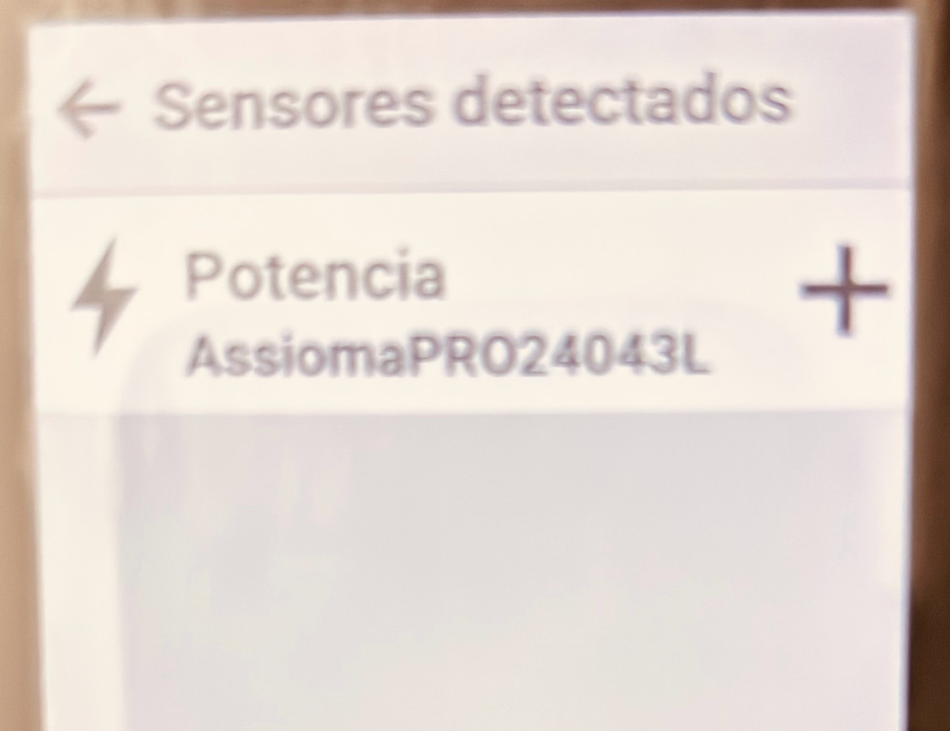

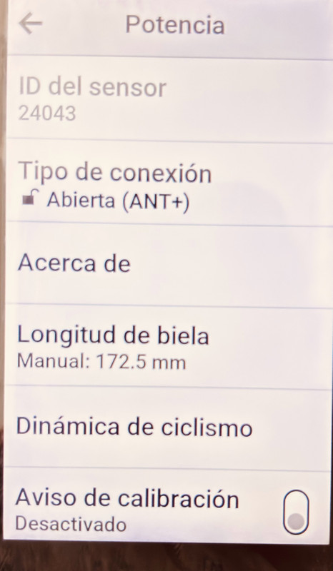

    In the photos, you can see the ANT+ option, and if I click on "Search for Sensor," the Bluetooth option appears (This is the case of my pro MX pedals on the gravel bike, on duo pedals it would be the same)
