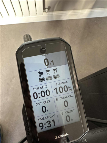

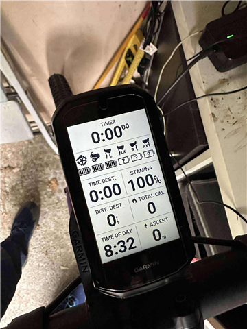

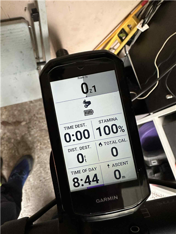

The gear battery field is not showing all the batteries now that I have added a second bike.  It used to work and show the shifters, the blips and power meter, but now now the first bike and the new bike, the field just shows the rear derailleur
Pictures show originally how it looked (although not sure why the three ? are showing).
I'm using SRAM on both bikes I should of said too.
Only started happing since I have connected the new bike and paired the sensors.
All firmware on the 1050 and the SRAM parts are up to date.
  • The question mark is an unknown battery status
  • I have it working! You can’t swap to a different sensor/bike as it won’t work. You have to power the edge off and power back on and then select the new bike. It then works!
    Just swapping from one ‘gears’ sensor to another causes the issue.
    Bit annoying that you can’t assign sensors to certain activity profiles, but at least I know the work around
    I have no question marks now on screen, not sure what why it did that.  Can only assume something to do with not powering down again if swapping from one bike to another.
