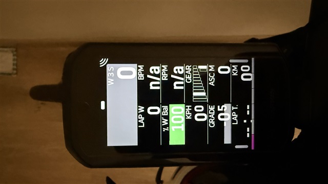

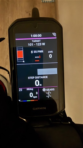

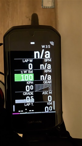

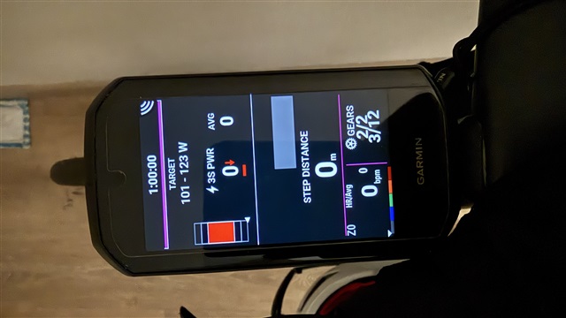

  • My setup is similar: 1050 and red axs. After Edge wakes up and AXS not activated by one rotate of cranks etc Edge shows Gears as -/- or empty graphics on custom data screen  But after AXS waked up immediately shows correct gear. See photos.
