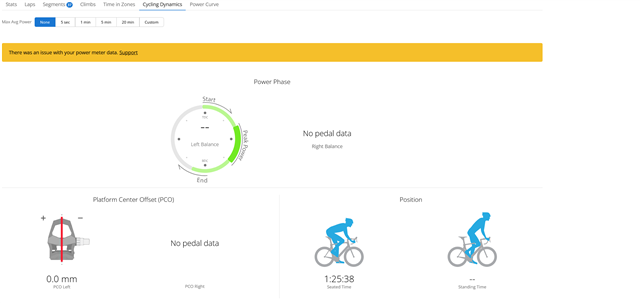

Cycling dynamics show like this with Favero Assioma (UNO) with my Edge 1050. They were working fine with the 1040.
Is it connected over ANT+? Go into the Sensor details to check, you can also see if Cycling Dynamics is enabled there.
Yes, it's connected via ANT+.
Also:
Honestly, I don't understand why is it displayed at all with a single-sided powermeter, totally pointless... If you're a para-cyclist and you only have one leg and that is the left one, then maybe...
The DUO version is working fine for me, over ANT+.
