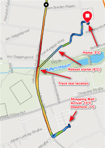

  • Perhaps more evidence to temperture dependant reboots:
    I made the same ride as the day before. Yesterday I had no reboots.
    Today I left the 1050 outside on my bike, when I entered the shopping mall for about 14 minutes. During that time the temperature measured by the 1050 had fallen from 13°C to 7°C. Real outside temperature was 0°C. After leaving the shopping mall, the 1050 started to show incorrect position and rebooted afterwards.
    Yesterday, I made the same ride, at about the same time and weather conditions. I took the 1050 with me into the shopping mall so that it could warm up: no reboot.
    To illustrate the situation, here is an image of my track:
