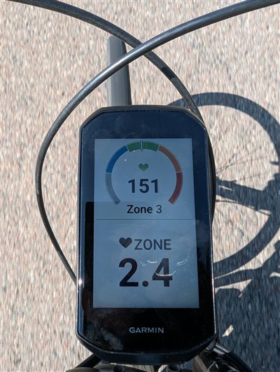

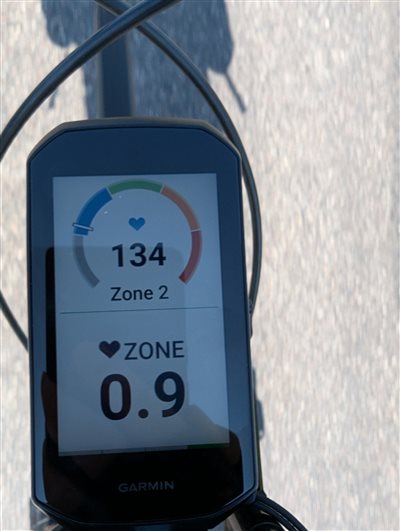

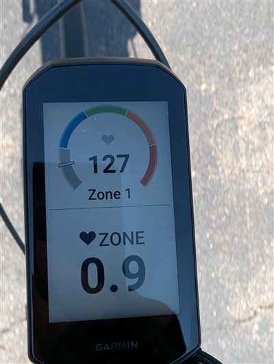

Hi,
It looks like there is duality how the Heart Rate zones are defined and showed in HR zone bar vs HR zone vs how time is calculated in Connect.
Looks like the HR zone is calculated based on my settings in Garmin (setting using %HRR), and HR bar is taking the zone from some other place.
Though i can say, that my settings on Garmin were pretty strange, and my zone 1 started at 64% of HRR.
Anyone else seeing this?
