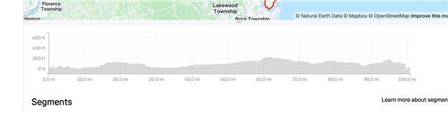

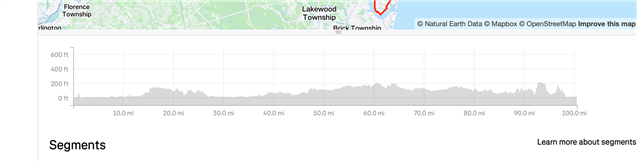

  • but you meant the original elevation chart is the same, not after the elevation correction on Strava , right? (because after correction the Strava redraw the chart by its own altitude datas, so the raw profiles on GC for both, i suppose your friend was not selecting the correction on GC)
  • That's a good point. Yeah, after I reverted the elevation correction, the chart looks completely messed up.
    Bad:
    bad
    Good:
    good
  • yeah, now we found your problem, the hole got dirty/moisured during the ride and it messed up the altitude data which messed up the total ascent also. blow it out and it will be fine during the next ride.

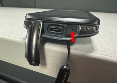

  • probably checking those 4 tiny holes midride and blow out a few times. the reason why the 1050 could measure it better (without issue) that the holes are at different place in the back if i remember good but i think there is no 100% waterproof design. and probably the placement is also a key, if it is on a front mount, that a bit worse than if it is on the stem. but i am just guessing, i am not riding in rain , just in dry sunny weather if possible, i hate cleaning the bike :)
  • The 4 small holes on the backside of the device is NOT the Barometer. Thata the beeper.
    The Barometer is the small slotted hole on the right side behind the battery door.
    support.garmin.com/.../
