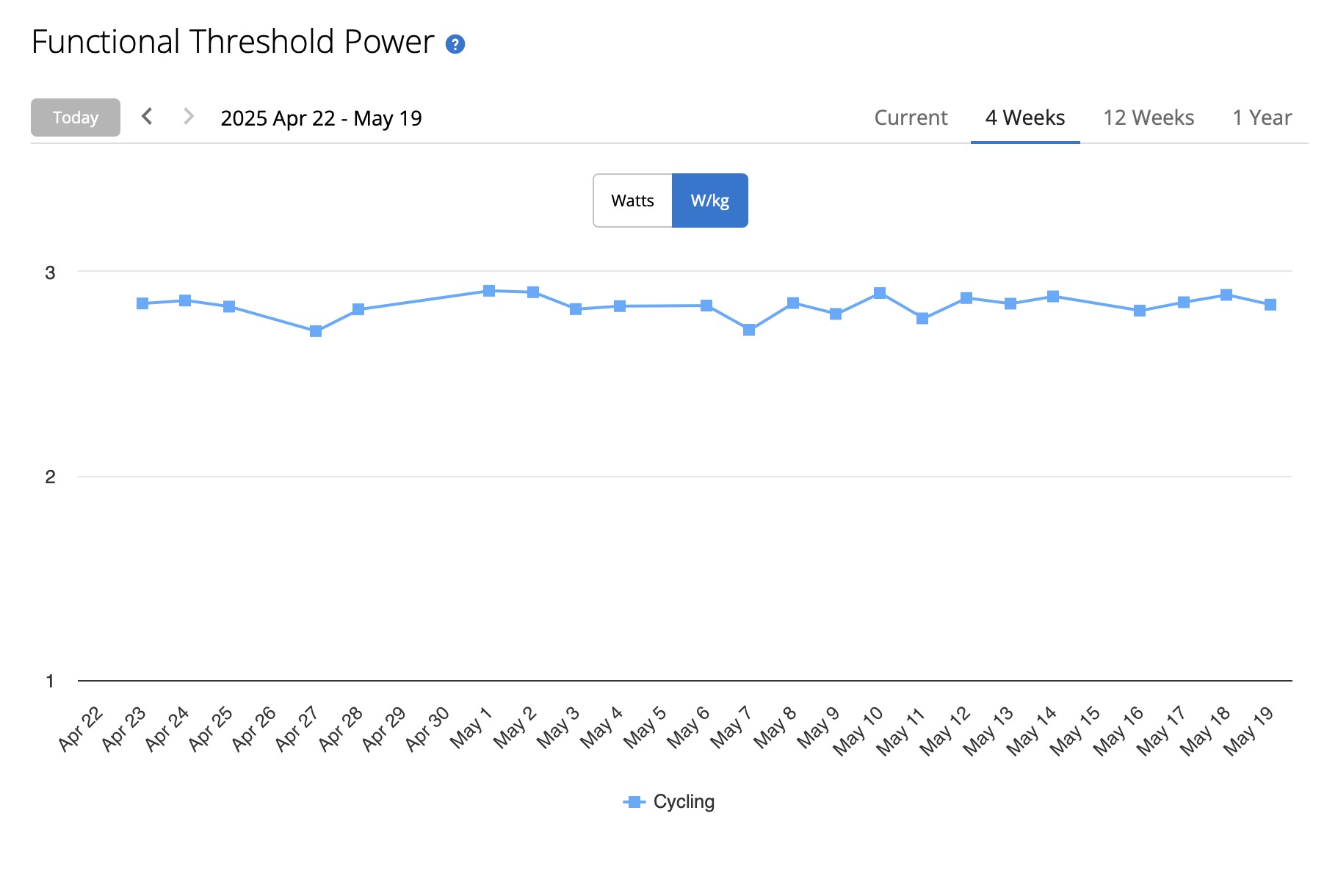

    Based on the visible data, what you're seeing is a sharp drop in FTP expressed in W/kg not in absolute watts so the most probable causes are:
    • A wrong body weight value; either manually entered, or pulled incorrectly from a connected smart scale or synced app.
    • Incorrect crank length setting on your power pedals;  this can result in large power inaccuracies.
    I suggest checking:
    • The FTP (in watts) chart for that period;
    • Your weight graph around May 9;
    There is no change in Garmin's way of calculating FTP. Here's my own chart — nothing dramatic has happened in years. Slight smile

  • Even if you didn’t change anything manually, it’s worth checking the FTP (watts) and weight graphs in Garmin Connect around May 9. Sometimes values get updated by a smart scale or a connected app.
    Another thing to consider: Garmin devices sometimes lose sensor connections mid-ride. If your powermeter disconnects, the device may record zeros instead of “no data,” which drags down the average. If such a ride is used to estimate FTP, the result can be unrealistically low.
    Drastic FTP drops are rarely due to chronic conditions. Tthey’re usually caused by acute incidents like injuries. Not even COVID knocked mine down by more than 10–15%.And you're right: these algorithms are built around “average” users: average age, weight, fitness, and health. But no one is truly average.

  • With the new information, it’s clear that the change came from an update to your FTP, not from weight differences.
    On the power chart in Garmin Connect, you should be able to tell whether the 172W value was a stale value or the result of previous estimations. The dots on that chart will indicate recalculation events.
    We don’t know the full details of how Garmin estimates FTP, but we can safely assume that Max Average Power over 20 minutes is a key input. To assess the level of effort, Garmin likely uses heart rate (HR) data as a secondary signal.
    In your case, this is the most likely suspect, since your HRM-Pro could have been affected by rhythm irregularities(like PVCs), which can confuse the sensor. An optical HR sensor (like a Garmin watch that can broadcast wrist-based HR), while less precise for most people, might actually be more robust in the presence of irregular heart rhythms — because it doesn’t interpret electrical signals, just blood flow.
    Looking at the data from your rides, you’re right that the old 172W estimate looks overly optimistic.
    For comparison, with a current FTP of around 200W, my numbers for similar rides are roughly double yours, as expected, since I’m approximately half your age.
    So at least now, the data seems more plausible. And even if we never find out exactly what caused the earlier overestimation, there’s probably nothing that needs fixing.
