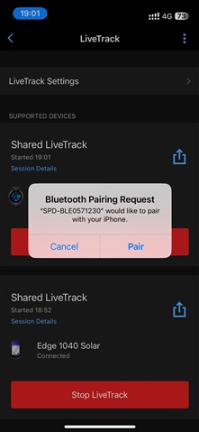

I'm experiencing a recurring issue when cycling with my Garmin Edge 1040 and a Garmin Speed Sensor (v2). If I open the Garmin Connect app on my iPhone during a ride, I start receiving a cascade of Bluetooth pairing requests from the speed sensor. These appear continuously—dozens per minute—making the phone nearly unusable. If I accept one, the Edge 1040 starts acting as if I've stopped moving, even though I'm still riding.

This screenshot illustrates how repeated Bluetooth pairing prompts from the Garmin Speed Sensor prevent any normal interaction with the iPhone.

  • Update: Possible workaround:
    I’ve found that removing the Speed Sensor from the Garmin Connect app's "Garmin Devices" section (not just forgetting it in iOS Bluetooth settings) completely stops the pairing spam during rides.

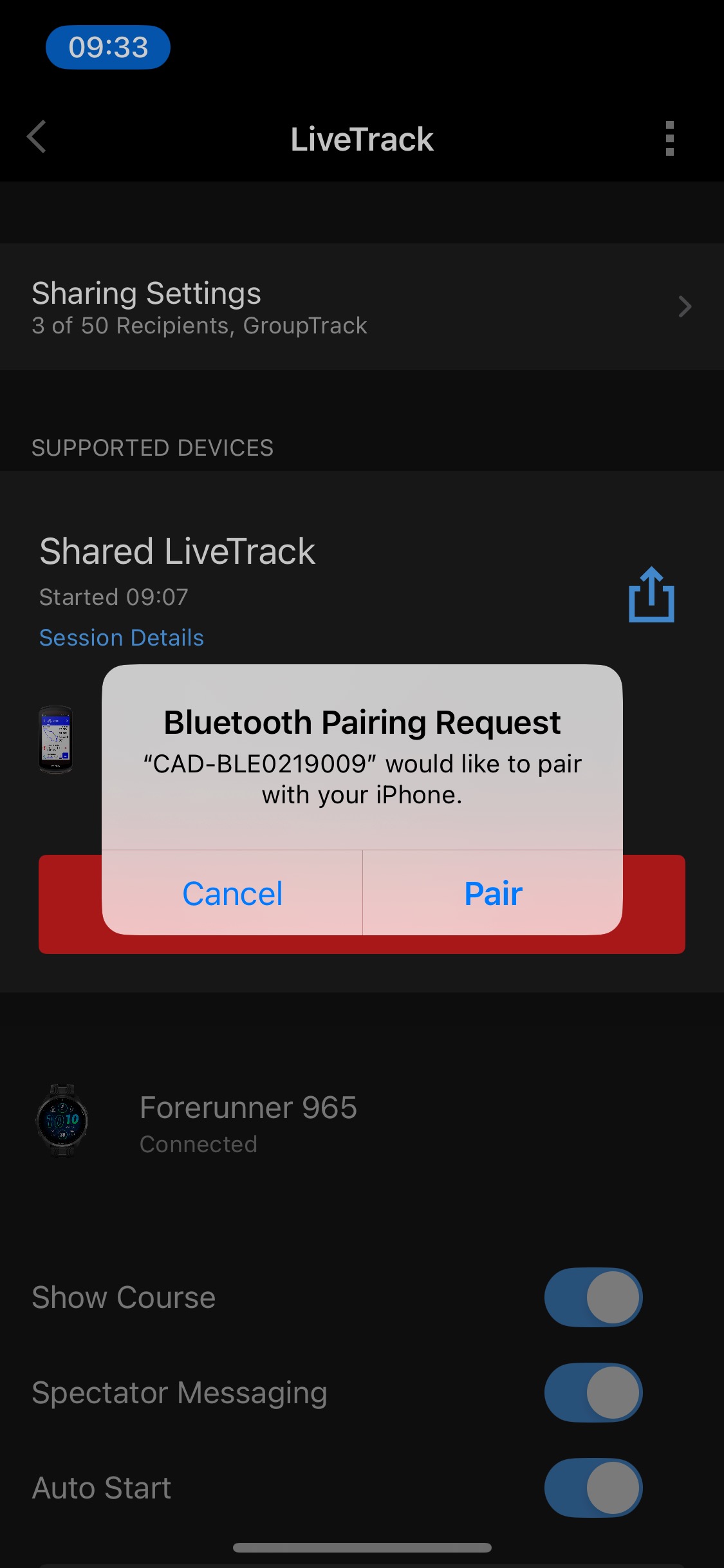

      After 6 days of peace, the ecosystem has found a new way to torment me: this time it's the Cadence Sensor spamming Bluetooth pairing dialogs on the iPhone.
    And here’s the twist: it doesn’t even show up under Garmin Connect > Devices, making it even sneakier than the Speed Sensor.
    creenshot of Bluetooth pairing spam on iPhone from Garmin Cadence Sensor
    So the previous workaround; removing the sensor from the app; doesn’t apply here.
