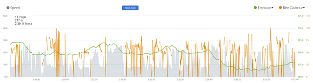

    The data from the cadence sensor has a lot of gaps in it. And since it happens also during hill climbs, it does not look like the gaps are there because you stopped pedaling. So yes, it supports the theory that the sensor may be perhaps switching from Cadence to the Speed mode. Though, I do not know whether it is really the sensor, or rather the processing on Edge that causes the wrong data interpretation.
    See below a zoomed section from your Merida ride - the orange curve is the Cadence (elevation green, and speed gray). Far too many gaps in the cadence data, so there is definitely something wrong with the sensor (or its processing).
  • Thanks for the feedback .  The 1040 keeps searching for sensors all the time & the 1030 I had previously stops searching for sensors soon after turn on.  This is why I probably never noticed this bizarre speed display on the 1030 - it just used the gps all the time but the 1040 may be swapping between GPS and sensor when the GPS gets weak (with trees about).  I have removed that cadence sensor from the Merida, lets see if the speed is more consistent next ride.
