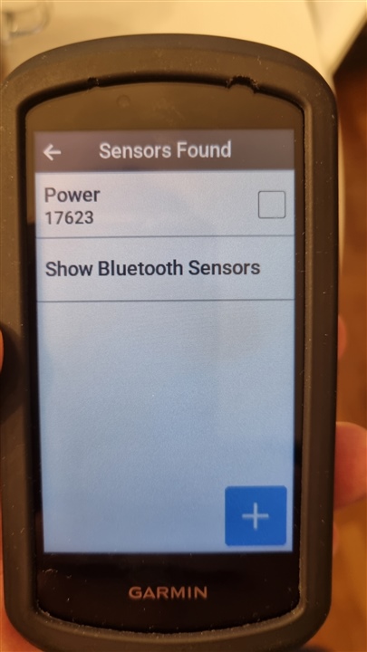

  • Hi, you probably need to remove this pedal power sensor from Edge, and then add again. You should be able to connect it as ANT+, i.e do not choose Bluetooth option, just wait it appears without using "show Bluetooth" (see picture attached).
    And if you want still to connect is as Bluetooth - first make sure you disconnect it from your phone, PC etc (e.g. by switching off Bluetooth on those devices). I can't find right now if Assioma MX supports multiple simultaneous BT connections, maybe not... if this is the case, then your phone may interfere Assioma's BT connection to Edge, and it may look as you described above.
    So it's slways better to connect with ANT+ option.
    Hope it helps.

  • Hrello DennisF
    I was convinced I had installed the right sensor. But indeed a difference between BLE and ANT+. See pictures.
    Right one is ANT+ and left BLE. And it works now, several tests done. Unit Off, unit on and right away the correct indication.
    "Verbonden" means connected.
    DennisF thank you very much for the solutions. Big Happy.
