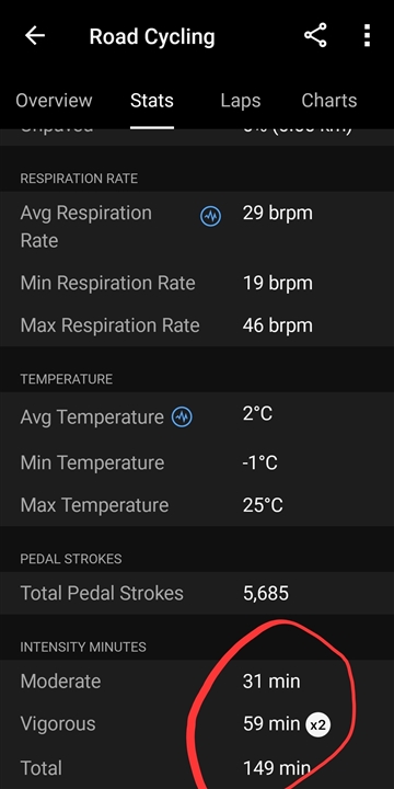

  • Thanks for the explanation. The cause you say is in the direction what I thought.
    But I had also the case where I recorded with the Edge 540 + HRM (not pro+) while the watch was SHUT OFF and I had the same problem. I found out this was because the Edge had bluetooth connection to the Garmin connect on the phone while recording. I have also to disconnect the Edge from the smartphone while recording. Then I get activity minutes correct and and even daily heart rate, which should not be the case according garmin.
