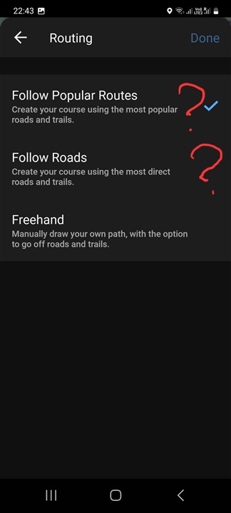

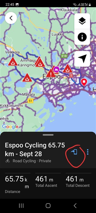

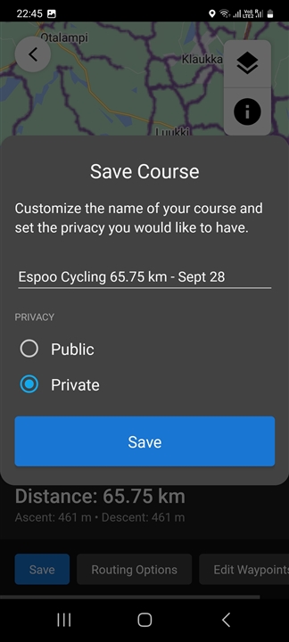

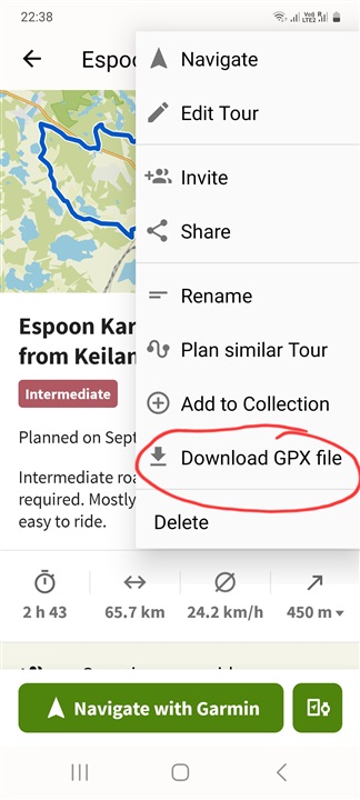

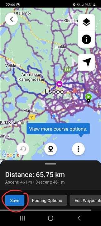

  • Thanks for your hint for opening GPX file with Garmin Connect Mobile app on the phone. Brilliant! But this step requires internet connection, otherwise GCM can't import GPX.
    After that - just a direct transfer of new Course from Connect app to Edge via bluetooth. Here again internet is required, otherwise GCM will show no courses in its list.
    I just did a test, it works fine. See in attached screenshots, this is Samsung on Android.

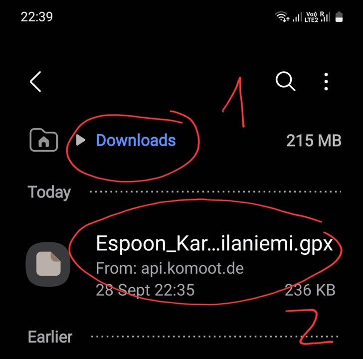

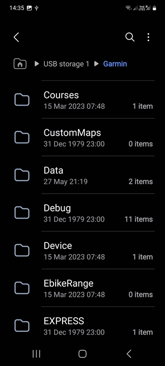

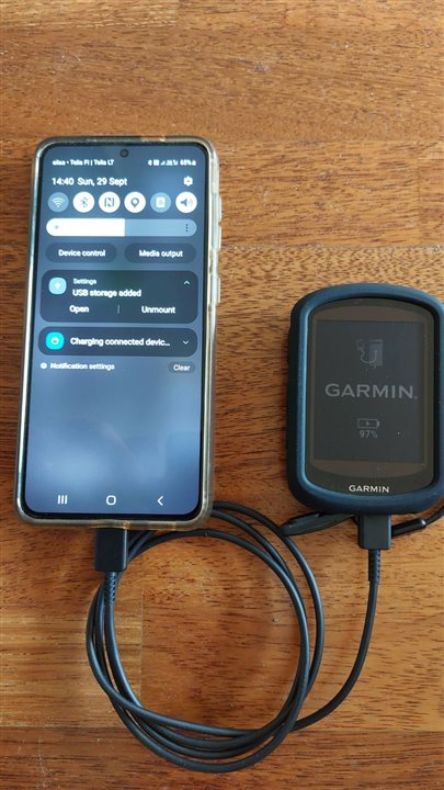

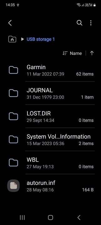

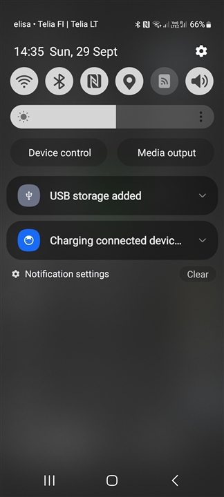

  • I was able to upload GPX from phone to Edge 540 directlt via usb-c - usb-c cable. Edge got recognized by phone as External USB drive.

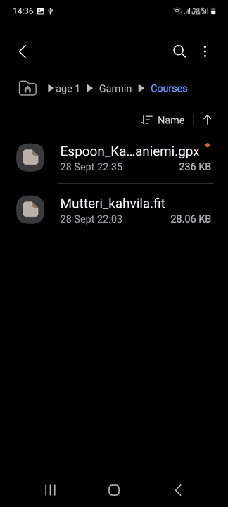

    I copied GPX to Edge's Courses subfolder.
    But this did not help fully, as Edge can't use GPX, just doesn't show it in Courses menu on device. I guess the file needs to be in FIT format, not GPX.

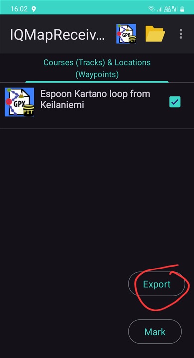

  • Allright, GPX-FIT converter IQMapReceiver can be used to convert GPX into FIT format.
    Note, it doesn't work for direct sending to Edge. I was just able to save FIT file inside my phone, and then transfer it to Edge by usb-c - usb-c cable (see my post above with demo).
    After it, Edge 540 immediately displays a new course on main screen and you can ride it. No internet required for conversion and copying to Edge, just a cable.

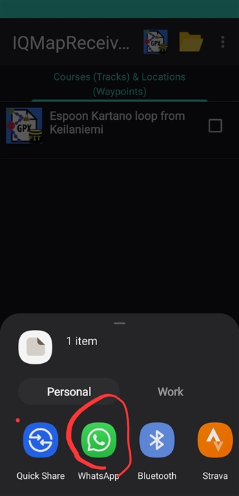

    However, the most tricky part is how you can save (export) FIT file to the same phone. I found the only option is "sending" the file from IQMapReceiver to Whatsapp, and tthe inside of Whatsapp - to any contact, e.g your friend. Note, we're doing this offline (no-inrernet zone) so the file doesn't go anywhere, it just saves as data file to phone's folder /internal storage/android/media/com.whatsapp/whatsapp documents/sent
    From there I copied it to "Downloads", then renamed to "test.fit". And next I copied FIT file to Edge 540 connected by cable.
    This is very odd way of saving the file, not for usual users. I couldn't find any better way yet. Maybe some of you will have other apps on the list of possible destinations for FIT file export from IQMapReceiver app that may work for you with less hassle than whatsapp, smth like email app or other you may try and find.
