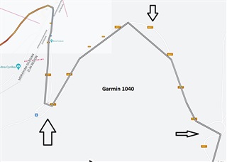

I just drove 300 km with my girlfriend. I have 1040 and she have Explore2.
Most of the ride we rode more or less close to each other, just uphill of course with various VAMs.
After all, I had 300km and she have 305km. quite a big difference ...
I did some digging and notice that GPS is sooo inaccurate. I never thought about this till today. Is is a normal accuracy for this devices?
Of course, settings for accuracy in devices are set to MAX in both. Is there any other option to have GPS more accuracy?
See in pictures interesting part of our ride.
  • You need to be a little careful in what you are viewing the activity with to make GPS accuracy claims. Garmin Connect Web will down grade the data when drawing the plots so as not to pull thousands of data points. This results in corners being cut etc.

  • The track points from both devices are in different places on the same road, so it’s not a GPS accuracy issue. The straight lines are simply joining the points together and when moving fast the distance traveled between them is greater than when moving slower.
