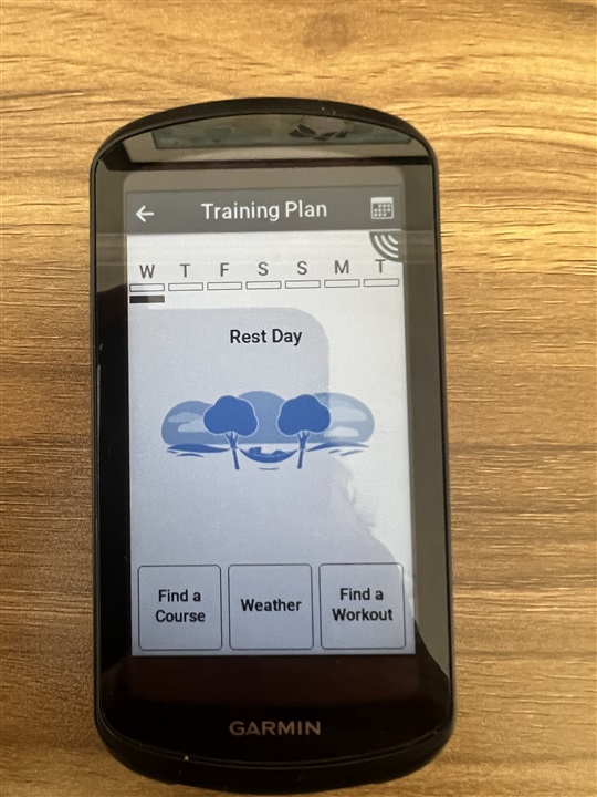

Firstly, I will preface this with I always use a HR strap and a power meter whilst riding my bike - every session. Recently, all the Daily Suggested Workouts have vanished from the Training Plan and when I go into the Training Plan for the week every day is listed as a Rest Day. When I go into Workouts and select Daily Suggested Workout, I get a message that says, "Ride with HR and Power to get daily workout suggestion or download a training plan from Garmin Connect".  I do have a Garmin Forerunner 955 and when I go into the Daily Suggested Workouts on that device it seems that all the workouts are there and aligned to what I'd expect they would be. The Garmin 1040 is set as the primary training device in Garmin Connect, I do not have a training plan or coach active. Randomly the DSW come back and then in the morning they seem to disappear completely. Does anyone have this issue or can tell me how to fix it?

  • So what I have found is that the DSW's magically come back between 10am -11am AEST, prior to that they are not there at all. My guess is that this is a timezone issue. Today, I turned the device on at 0620 and the DSW were completely blank - recommending rest day each day. I did a workout between 06:20 - 08:00 saved the workout and shut down the device. Turned the device on again just before 0900, workouts were not there so turned the device off. Turned on again at 0950 and was still the same - no workouts so turned the device off. Turned the device on again after a meeting at 1107 and voila - all the DSW's had magically returned for the entire week! This seems to have every single day.......surely something on Garmin server side?
  • At exactly 10am AEST the DSW all come back, prior to that they are gone. I suspect from Midnight AEST as I woke up at 1:46AM and the workouts were not there (yes I have nothing better to do :) they all reappeared at 10AM AEST this morning.  - can someone help me? Surely I am not the only one having this issue.....I've tried everything.
  • Here is a video of what happens every day for my Daily Suggested Workouts - at midnight they all go away and stay away as per the start of this video. At 10am AEST per the video you can see all the weekly workouts magically reappear! This is highly annoying and makes the use of DSW totally useless given I ride in the morning. Garmin - Please help!!

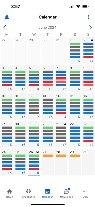

  • Seems to be a bigger issue - I figured that I’d start creating my own workouts again given I can’t use Garmin’s Daily Suggested workouts. They also don’t sync from Intervals.icu - despite being in the calendar in Garmin Connect shown below. They sync perfectly to my Forerunner 955.
