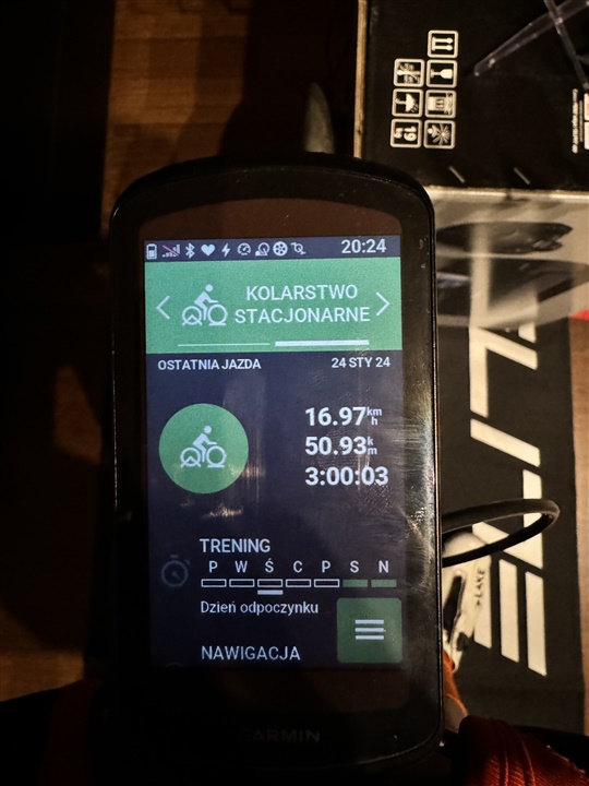

Today I noticed that my edge doubled time of training. I trained 90 min whereas EDGE showed 3 hours. And the samy average speed is lower twice. Any idea?
After training, I manually changed the training duration.

Not sure which one would you like. One is from yesterday - the duration was ok, but I don't know why EDGE gave me training, not the same that I have in Trainingpeaks. I noticed it after training because both are very similar.
The second is from the 24th of Jan, where the duration was doubled by EDGE.
