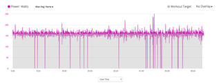

I have my kickr 18 connected to my 1040. I have noticed on my Garmin 1040 that the power numbers drop off continuously for a second. They come back but then keep dropping off. I am not sure why this has started. Are you able to help with solving this issue? I have attached the screenshot from workout yesterday. Any thoughts why there are power drops to the Garmin 1040 would be great.
  • what i always recomend: unpair the Kickr as indoor trainer from Edge, pair it only as power sensor, and control it via Wahoo app or with other apps via BT.
    the 2.4ghz wifi channel <-> ant+ freq collosion could be a problem source also, so check wifi router what channel is used in the 2.4GHz mode (do not use auto setting, set it manually to a low channel , between 1-4 is good. but the best is the 5GHz wifi, without 2.4Ghz mode, then there is no interference)

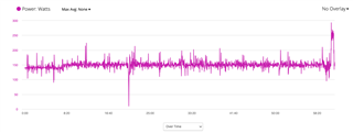

  • thank you I tried your suggestion yesterday and it worked great!! I actually recorded with my Epix2 but suspect it will also work with my 1040, will try this afternoon. So I unpaired the kickr as a trainer and repaired as just power source. I then used the Wahoo app as the controllable source and PERFECT! see attached no drops. so will do the same with 1040 today and report back. if this is the solution do you have any suggestion on gettin my workouts to a controllable source as I usually use erg mode and let the trainer change the resistance?
