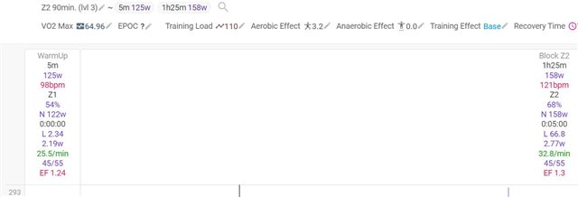

The Edge1040S almost always presents a level .... 21-23% (!?) and describes it as low.
Well, the "interval.icu" platform presents me with a training completion compliance of ~99-100% :)

Well, such that the Edge1040S after the workout displayed a performance level of ~21-23%, while the Forerunner 955 rated the same at .... 97-98% !!

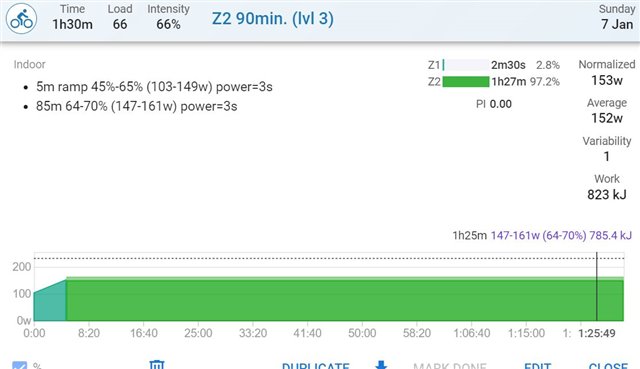

    Note that your Forerunner has an advantage of reading the same power data that Xert is reading (and optimising by adjusting the resistance), so it's no surprise that it's usually spot on the target (minus control delays, gear ratio limits, etc.) and shows high execution score. Your Edge reading your Assioma pedals does not have this advantage, so it needs more margin to be considered in range, as shown by the experiment. Or you can still configure the intervals.icu target type to be the lap average power (rather than spot power or 3 second average power) and then the workout execution score should be even closer to what you are looking for.

    Regarding the fact that in "interval.icu" I can use the power from the block/interval instead of "3 seconds" I always had that - except that the required %TP was rigid (in the screenshots shown above - it was 67%TP by default).
    After your suggestions, I changed the required %TP to a range of 64-70%TP which resulted in an improvement in the workout performance rating.

  • Are you sure you can't have a range for the lap power? The target range should be independent of whether your target is lap target, instant power, 3s power, etc. See this screenshot for reference: https://forum.intervals.icu/t/workout-builder/1163/379
    I can imagine that ramps wouldn't work with lap power, but ranges totally should.

  • I can set %TP and averaging for the whole lap.
    It's just that in that case a narrow range of power will be displayed on the Garmin (E1040) - like in my first screenshots where you wrote that the margin is too narrow.
