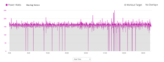

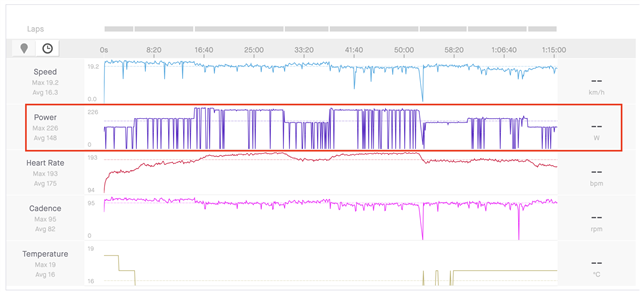

Just received and updated my 1040 Solar to the latest firmware. I used it for the first time last night with a structured ride. It is connected to my Kickr (v5) and was consistently having micro drops in power. I have used this Kickr on Zwift and have never had an issue like this. HR, speed, and cadence never dropped. I only have my Kickr and HR monitor connected to the 1040. All of my equipment is updated, I assume the connection was using Bluetooth, but I have yet to try it again using ANT+.
Here is a screenshot of my 1040 micro-dropping power, you can see it is just the power dropping, resistance stayed the same the whole workout.

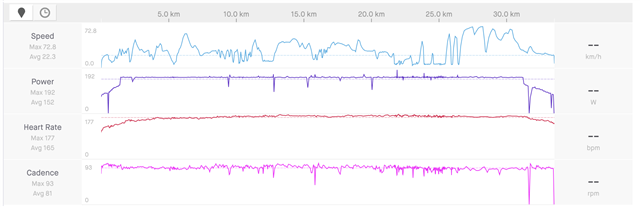

Here is a sample workout with my trainer using Zwift, the trainer is not dropping power once. I doubt it is my Kickr.

  • dont use the 1040 (or any x40 model) for trainer control, this is my advice. they made it unusable since a few months. control it via Wahoo app or any other app/sw via BT or ANT+. or use an older Edge (the x30 series is STILL working Slight smile)
  • there is no BT (FTMS) control in the Garmin devices so You could only control it via ANT+ (FE-C)

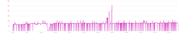

  •  have you tried this suggestion from Luko79? I am also experiecing drops on my 1040 but I am also using the 1040 to control the kickr for erg mode etc.
