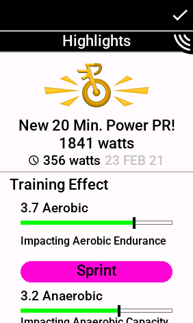

This has been going on for YEARS. I started a discussion in the 1030 Plus forums in July of 2022...
But now it's happening on the flagship 1040 Solar unit as well...
Yes this is the latest firmware.

If you pause an activity, the device automatically goes into sleep mode. Garmin would have to remove it from the firmware.
If „Profile -> Auto sleep“ is disabled, the device does not go to sleep when paused!
(Just tested for…
I will be using your cunning technique to finally get a decent FTP, currently it just calls me "poor" or "untrained" , at least it will stop wanting to increase it by a watt or two at the end of rides…
(Just tested for 15 minutes. V 19.22)
