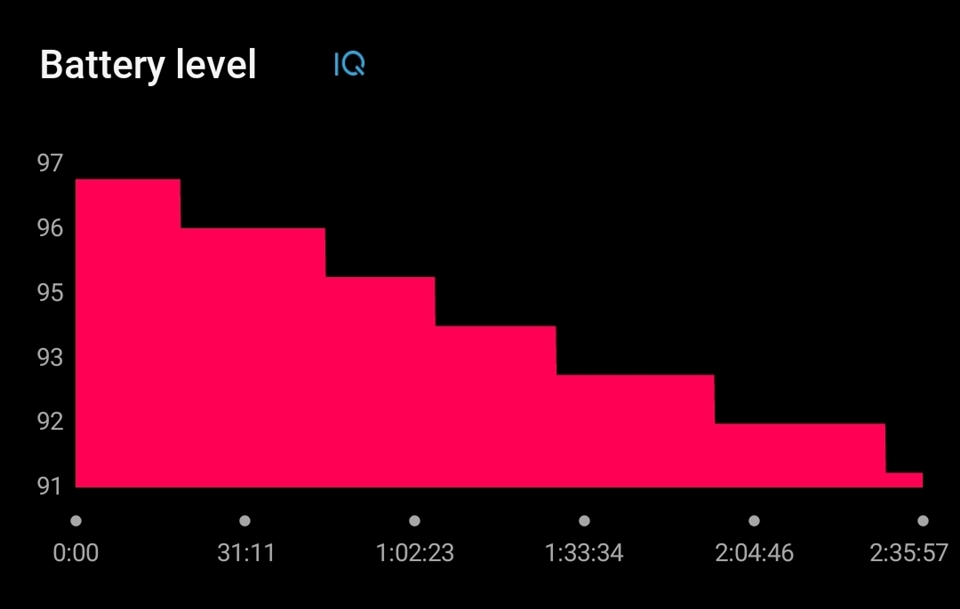

    Thursday ride to work ( previous firmware):
    Today ride to work ( 19.19 firmware)
    My route to work is a pretty good indicator, because it's always the same distance, the same route, covered at the same hour :)
    Connected sensors: heart rate monitor, cadence sensor, speed sensor, varia rtl515, edge remote
