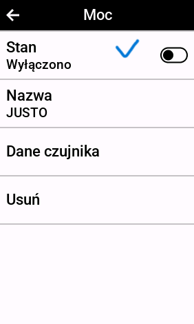

  • I have Justo and edge 840, I have connection, I start training with inteligent trainer, I have ERG mode, it is working and then after ca. 10 s it stops! Any recommendation ?
