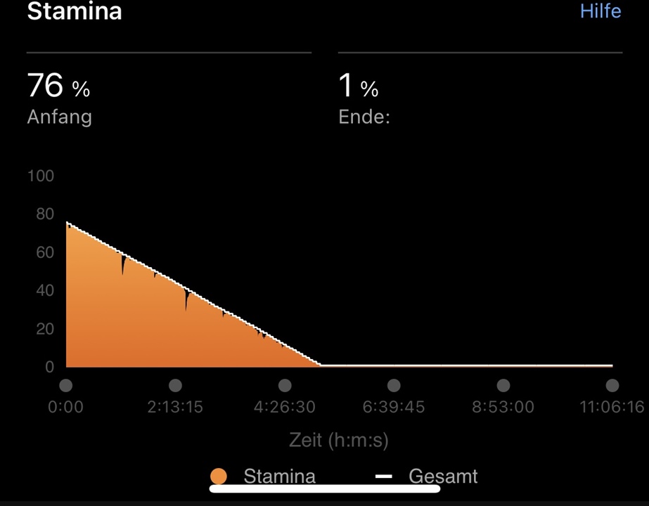

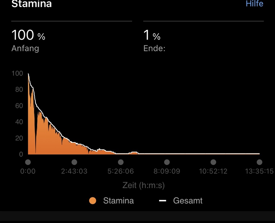

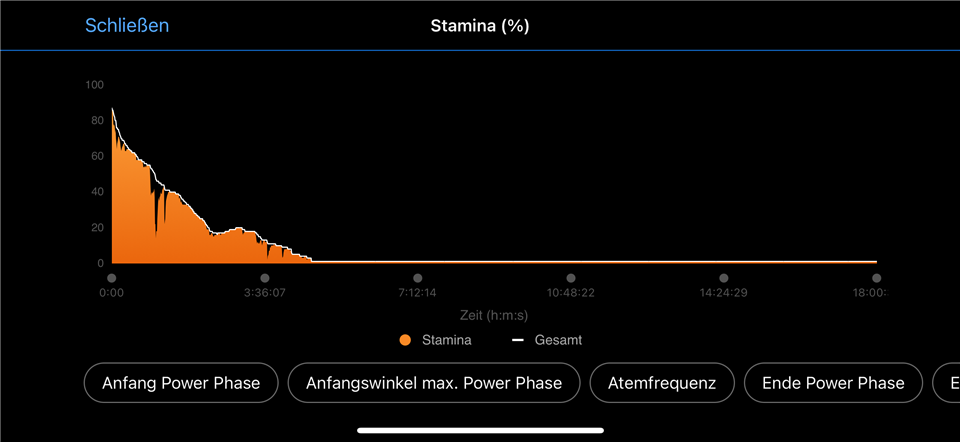

    Same here. After Stamins was against zero I rode another 200km. Completely useless.

    I use dual sided Assioma Favero Power pedals and a Polar H10 Heart Rate Strap. Every ride. Since years.
