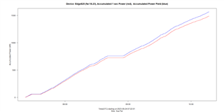

  • So the difference is due to the fact that the Edge and Strava are computing the value off of different values in the FIT file.
    The discrepancy between the values if due to communication issues from the power meter to the Edge and how those lost signals are managed.
    The power meter sends torque/cadence from which the Edge can compute power. Each message also contains an accumulated value.
    If you look in the FIT file you will find an accumulated_power value and a power value. If there were no data loss then the sum of the individual power records would equal the reported accumulated power.
    In this case there is around a 5% difference.
    The accumulated power is 1564778 kJ
    The sum of the individual power records is 1486061 kJ
    The activity duration is 8,688 seconds.
    This gives averages of 180 and 171.
    if you look at the plot below you can see how these two values diverge.
