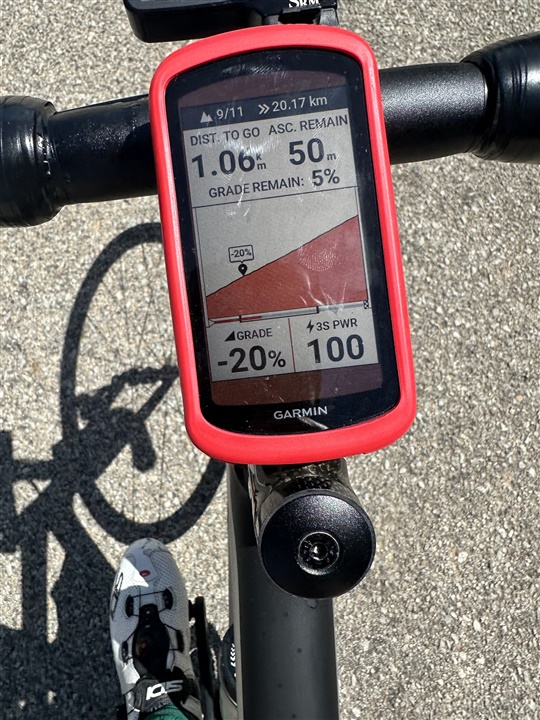

Hi. Thanks for answering. Yes I do and I tried either manually or automatically but after a few minutes it’s again super wrong
Is the temperature reading way off if you display that value?
Thanks . Not more than the usual overrated one. .
