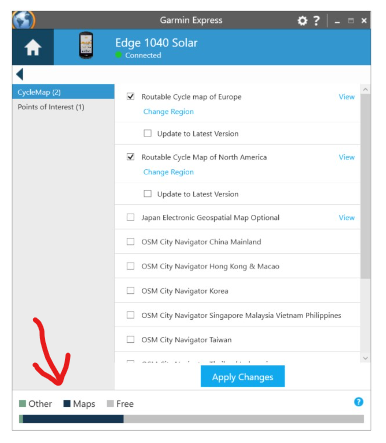

  • Do you get the error when installing either the Europe maps or the North America Maps (not both)? It could be that there is not enough space available on the 1040 to install both due to the recent size increase with the ClimbPro Free Climb data that was added.
  • I had a similar problem when trying to install an updated Europe map using Garmin Express . I managed to resolve the issue bij installing the latest version of the Garmin Express application on my MacBook
  • Yeah, tried individual updates and still get the same error, Express is up to date, so a bit stuck really... I'd delete the map file and overwrite it but there are a few files in the folder and not sure which is the main one nowadays
  • You can remove the maps via Garmin Express, just uncheck the maps and click ok. Then try to reinstall a single map (either NA or Europe) to see if that works.
    Issue is that when both NA and Europe maps are already installed, updating a single one won't work due to limited space available.

  • depending on if you have a 1040 solar (64gb) or non solar (32 gb) you may not have enough space for North America and EU due to the new climbpro data. They make the maps significantly larger. Prior to attempting to update the EU and NA maps, how much space did you have here:
