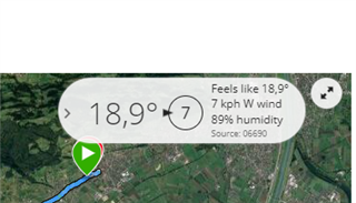

  • for the heat acclimation the Garmin gets the temp data from the nearest official weather station, mostly airports (and not from your Edge temp sensor), so if your Edge recorded 22-27C during the ride but the official weather station reported 18C, you dont get heat acc... (you can check it on the web version of Garmin Connect, here: click on the temp and it will show more details with station code: 06690, it is St. Gallen Airport, Switzerland, it shows 18.9C, i started at 9:18, it was already 25C when and where i started, which was not in St Gallen, i was on the south side of the big hill, St Gallen is on the north side, which is obviosly cooler on the morning, i almost died so strong was the sunlight even so early on the morngin, and i didnt get any heat acclimation because the GC think i rode all the 3.5h in this cool 18.9C. So it is a totally idiot feature, especially where the terrain is very different even in a small circle (mountain regions, Alps), or where there the official stations are very rare, and only just a few nearby and not on the same altitude as you start the ride (i have another example too, there is 300m difference between the station altitude and my starting postion, and obviously the station on 300m higher in the mountain gives you minimum 3-4C or cooler forecast which makes this heat acclimation feature meaningless...
  • Thanks for clarification, I guess that happend to me as well. Currently, I'm in Sweden in the middle of nowhere and the nearest weather station is probably 50-70km away.
  • if You can tell me that 5digit code as on my linked pic, i can tell you which station reported the temp data.
  • Wowsers, even lower than your temp.
  • the source is Karlstad Airport
