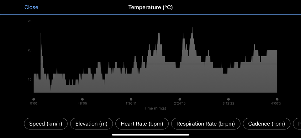

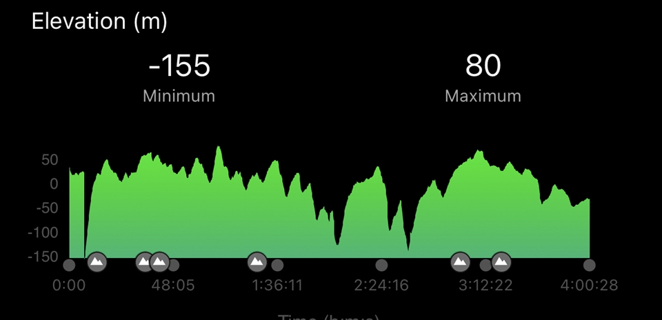

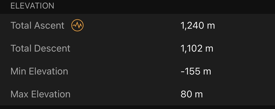

    today rode down into the village and the elevation dropped to -155m below sea level?  I was standing still.  See pic.
    it coincided with a spike in temperature that didn’t exist.
    and on a 9% hill it was reading -3% gradient?
  • But with auto calibration turned off for elevation it seemed to pic up the gain and descent reasonably correctly.  Similar elevation gain to my friends.
    with the elevation correction auto calibration on, it was well out previously.  Only half the elevation gain.
