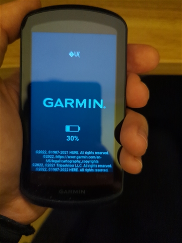

When disconnected, the loading screen had some weird symbols in the top section.
