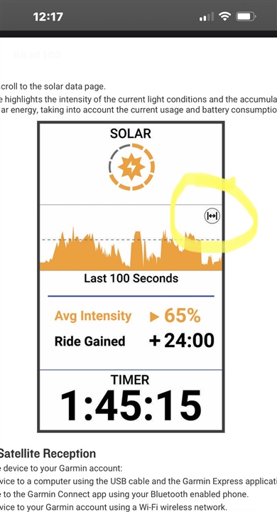

Do anyone know the purpose of this icon? I pressed it and seems to change the view but not sure if pressed to up/down if it stops anything? It does not say in the manual.
There is a similar icon on the elevation plot page. Tapping it allows you toggle between a “close up view” of a recent period of time, or an “expansive view” of the entire activity from the start.
Thanks. When clicking it for the close up it seems not to work. Maybe that is the issue I have been having during my rides with the solaR not working as it has been on close up view. Will test and see tomorrow. Downgraded to 12.15 again as well.
It will toggle between a 100 second view and the total elapsed time of the activity.
Thanks and for my unit it only works about 1/2 of the tile unfortunately. Been on the new FM and just went back to 12.15 to see if it changes things.
