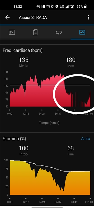

Firmware 12.15, yesterday at the end of the ride I saw the hr field in this condition '--' but the sensor in the sensor page was connected, battery is new.
In the uploaded ride in Garmin Connect the hr data wasn't present.

I have to report, that also the Scosche Rhythm24 have the same problem, HRM field with no data '--', but sensor connected, intermittently.
After four ride, three with the Garmin HRMDual and one…
Both ant+, other people got the same problem, it's really weird!

Same issue with mine 1040solar since 12,15 update. Unstable HR measuring (using Garmin HRMdual and connected to 1040 via ANT+). Sometimes it freezes, sometimes it jumps to unrealistic measures (way too…

I happened to have a brand new spare HRM dual (both the strap and the device) so the next ride I tried it and... same issue. Since then I'm using it with my Edge 830 and it works flawlessly, so it's definitely an Edge 1040 issue.
